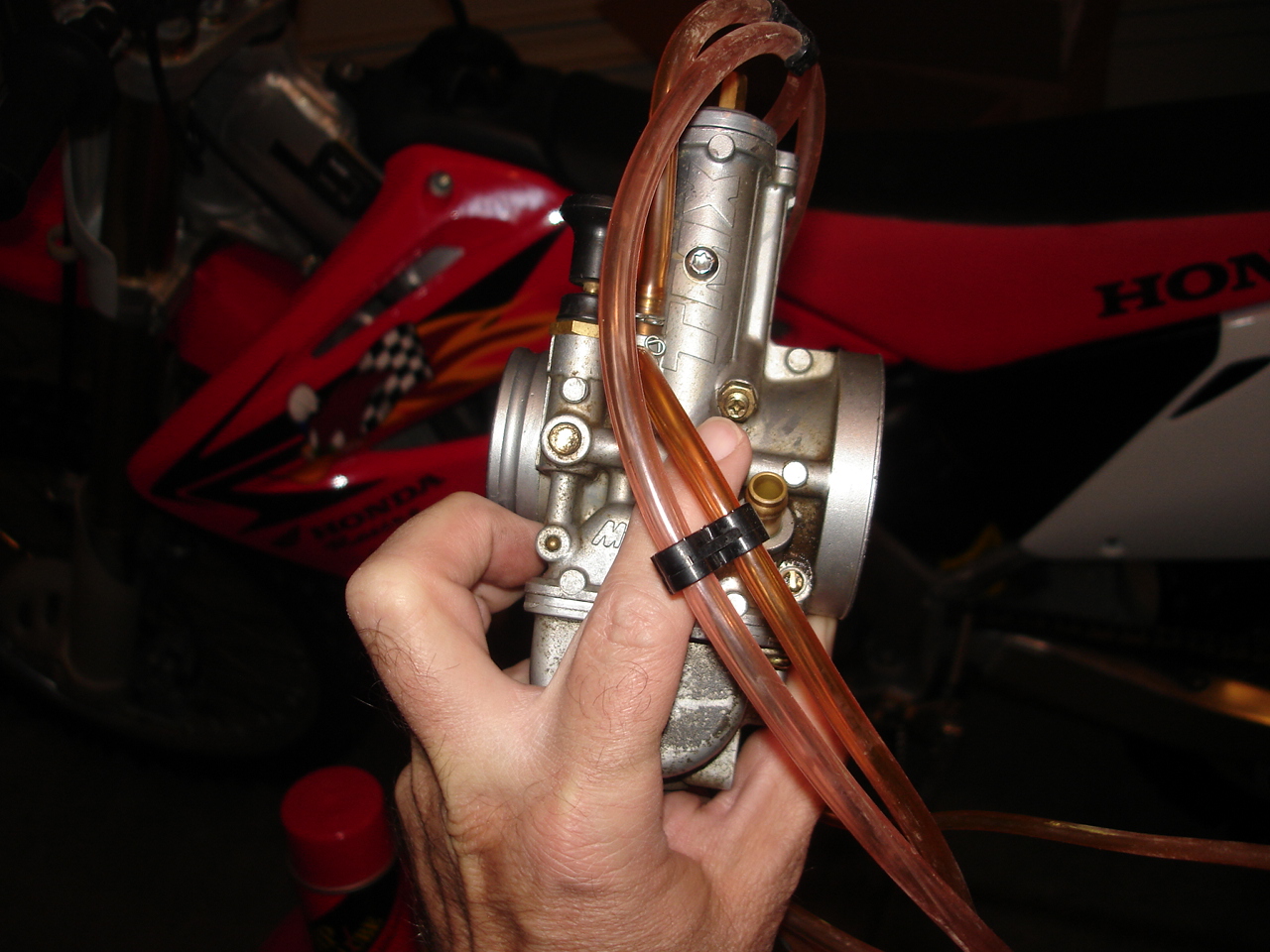

Took the carb apart today and cleaned it. noticed it had a 400 main jet and a S-9. I could get the spring loose to see what position the clip was on. if i pulled any harder, it was going to strech the spring. Tried everythign to get it out with no luck.
Got it back together and it fired up first kick.. Still the split second surges though.. :( Going to try 32:1 fuel mix and see if that helps (running 50:1 now).

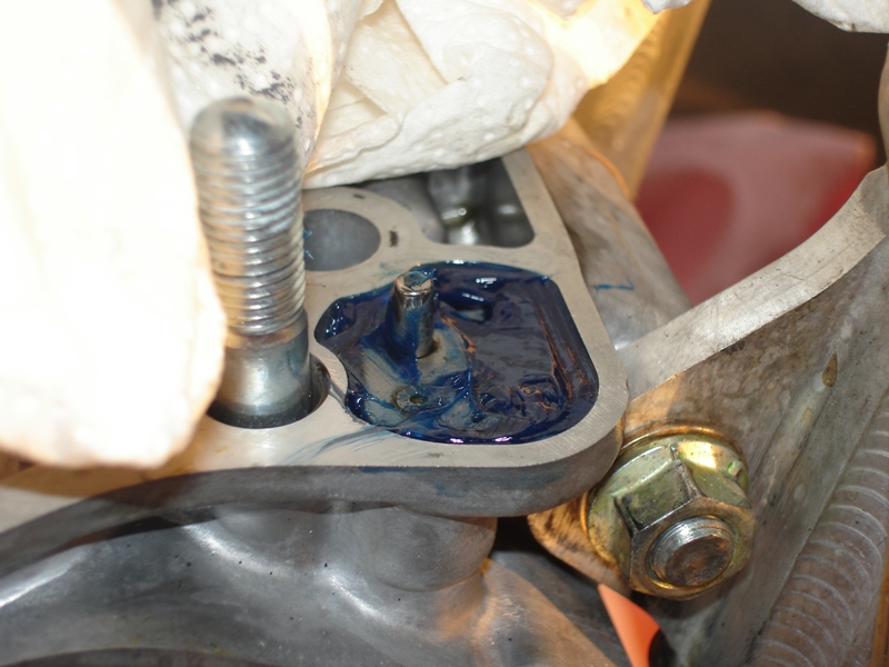

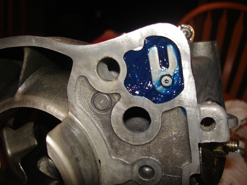

The Service Manual recommends packing grease and Moly 60 paste around the different powervalve drive shaft components (parts 11, 12 and 14 below) during assembly to seal the clutch area off from the exhaust port.
If this isn't done properly, exhaust pulses can pass through the PV drive assembly and into the clutch area and could cause some tranny oil to be blown out of the crankcase vent. Here's what mine look like before assembly.

There is another small screw with a nut to lock it in place, not sure what that is (I'm just a backyard mechanic).
On the Mikuni, the screw with the lock-nut is the idle adjust screw.

I did not pack grease in there when I put the cyclinder down.. is this going to hurt anything by not doing it or should I pull it back off and grease it up?
