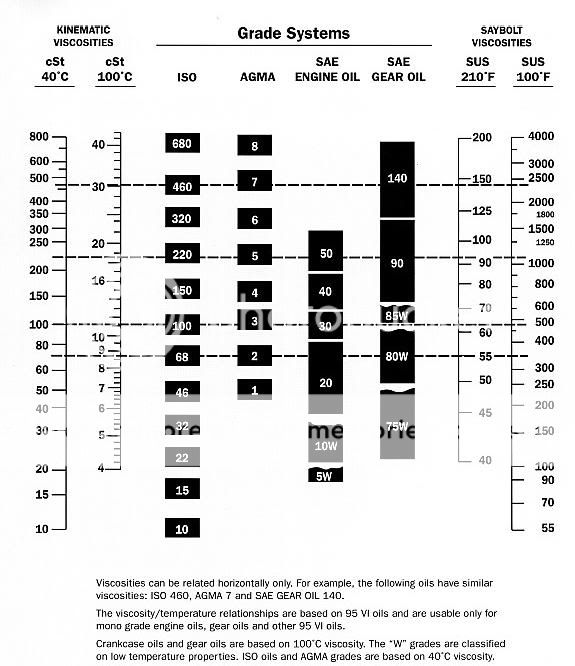

This chart shows the relationship between the differing grades of lubricating fluids.
Note that 80wt SAE Gear Oil is the same viscosity as thicker 20wt and thinner 30wt Engine Oils.
10w40 Engine Oil will be similar in viscosity to 85-90wt SAE Gear Oil.
