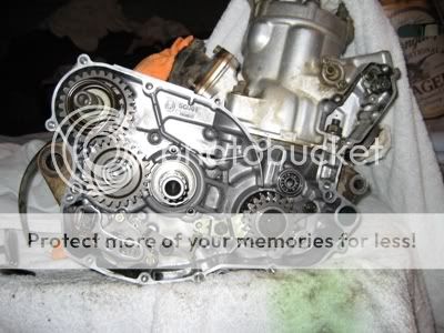

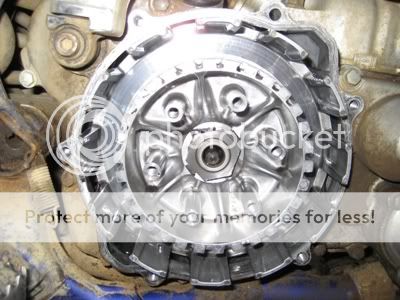

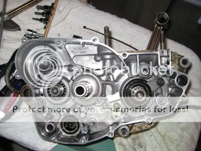

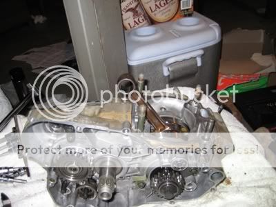

Problem is solved.... Turns out the oil port on the axle shaft got clogged and seized the 5th pinion gear to the shaft.
On with the pics.

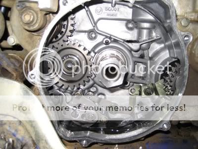

cluthwPlatesremoved

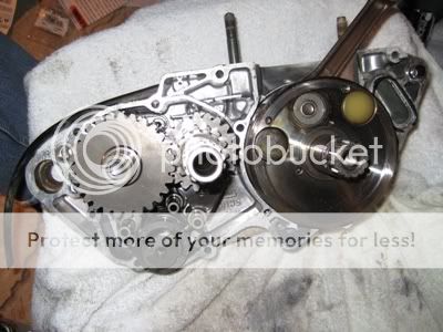

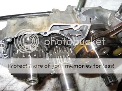

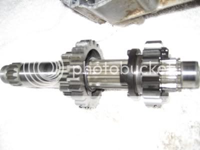

took about 20tons of pressure to remove this gear (2nd from left, first set of teeth is machined as part of shaft, Basically dead middle of pic... the gear basically welded itself to the shaft.

When you say the gear was "welded" does that mean that when it came off of the shaft it was replaced or reused? Also, the last and second to last pics posted... I am a pretty challenged person so tell me if I am right. The second to last gear on the left is the one that was seized? Ill make a diagram of the last 2 pics as best I can.
2nd to last pic--- 1st - 2nd - 3rd
last pic --- 1st - 2nd -------- 3rd(looks like it fits over a lock that fits into the gear to the left of it)
sorry for the 2nd grade approach that I need but I am the most illiterate person you'll meet
I have yet to take my specimen to school and take it apart, and am just trying to get as many details as I can before I get into it.
