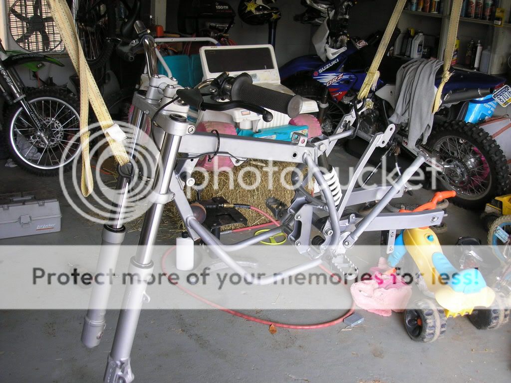

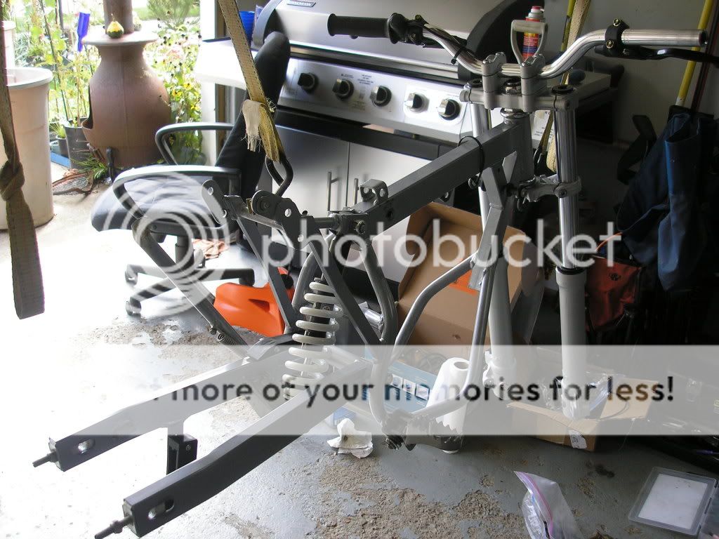

It's going back together now. Got the suspension all cleaned and greased and back on the frame. I sure wish the rims weren't all scabby, this thing is looking like it just came out of the crate. The factory grease had turned to glue, I had to pound the front axle out, thought it was going to be a rusty mess. Turned out that it was just glued in there with dried out grease.

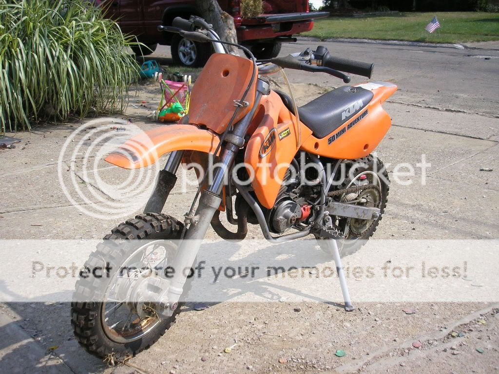

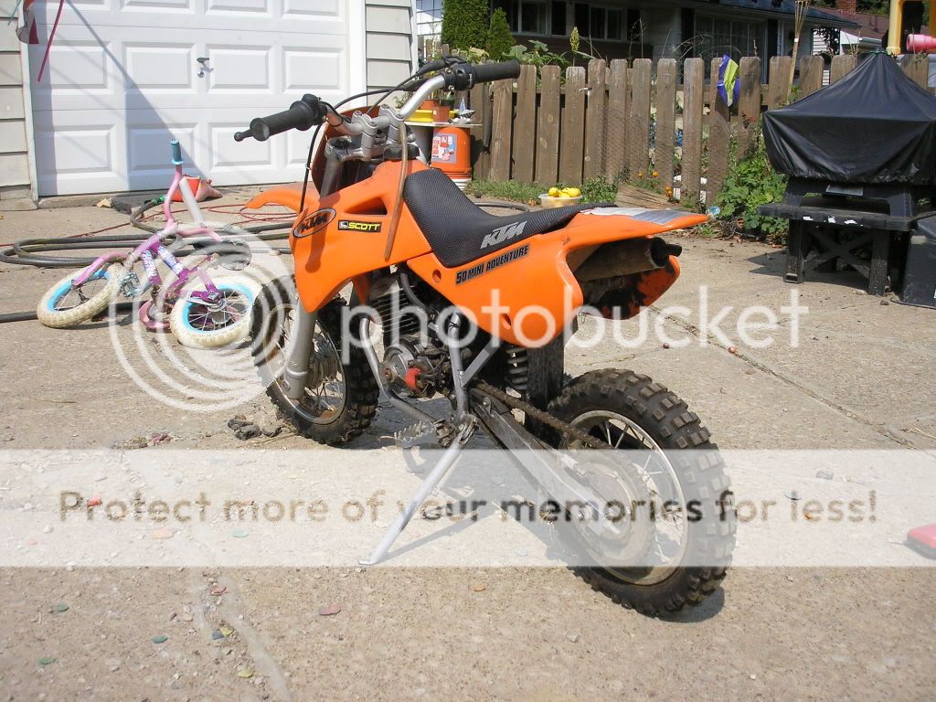

Here's some pics....

it looks very close to my old malaguti grizzzly that i have converted to a 125 engine :yikes:
very nice bike!!! they will like to ride it, it´s pretty fast... how are they on the pw and ttr???
