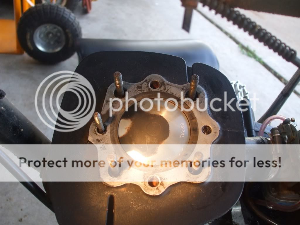

Cleaned carb, checked piston, filled with fresh mix. Bike runs great now.
Piston looked good, although it's about time for a light hone and a set of rings or a new slug. Have about 30 hours on this top end so far.
