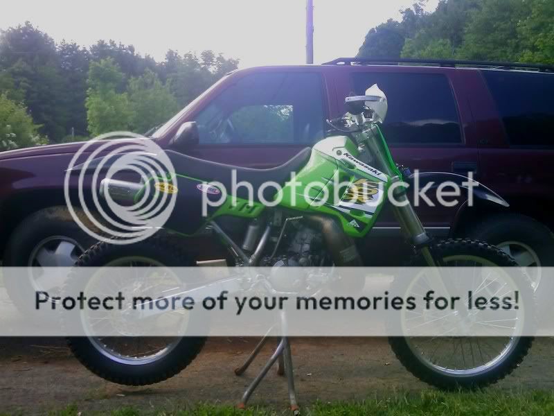

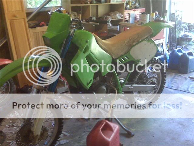

So it's taken a couple years, but I finally got it from this...
To this.....
1989 KDX200
RB modded head
DG pipe and silencer
KX500 rear fender
KX500 front number plate
UFO shrouds
Ceet Apex 06 Graphics
yz250 front end
Tusk Chub bars cut to 29"
Moose guards for mini bars
W.E.R. steering damper
Boyesen 607 reeds
airbox lid removed
42/150/1173n clip 3 (playing with this still)
Fresh top end: Wiseco pro-tru piston with cylinder plating by langcourt
Fresh bottom end: OEM main bearings and seals, transmission bearings relplaced, hot rods rod kit
Pirelli MT43 trials tire
That's all the stuff I can think of right this second, although it seems I have done much more, lol.

SWEET !! ... What a feeling of personal satisfaction you must have to have that bike underneath you. Another success story ! ... Domino

excellent work, built not bought is a real satisfaction IMO. you're not going to miss the lights??
julien_d
Oct 28, 2008
1,788
Haven't missed the lights yet. I might go with an aftermarket headlight at some point. All the headlight wiring was stripped out when I got it, so they never worked anyway.
Yeah, the inverted forks that were on there when I got the bike were 94 KDX USD's. No rebound adjustment, etc. Basically the same forks as the newer KDX's, but in USD form. I replaced the entire front end with yz250 parts, and have very much enjoyed the upgrade. I have the old KDX usd's in the garage. Might use them for some future project, or sell them.
Overall I'm really proud of the way the bike turned out. Any of my friends that ride it are very impressed with the bike overall. Handling, power, the whole package. I have no trouble keeping up with much bigger bikes in the woods. It's been fun, and uber reliable. Great bike!!
