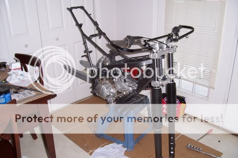

I guess I have no good close up pics.
This is assembling after repaining / full rebuild. Used dark gray on the frame and fork lowers, silver on the swingarm.
This pic is about a year and a half later, and TONS of riding. I probably easily had 100 hours on it, and the paint was just wearing thru by where the top of my boot would rub. Swingarm still looked good too. I was veyr happy with the durability.
Sold the bike close to 2 years ago. Seen it just 2 weekends ago, it still looks clean. Of course, it also still has the tires on it that I sold it with, and they are hardly worn at all.
