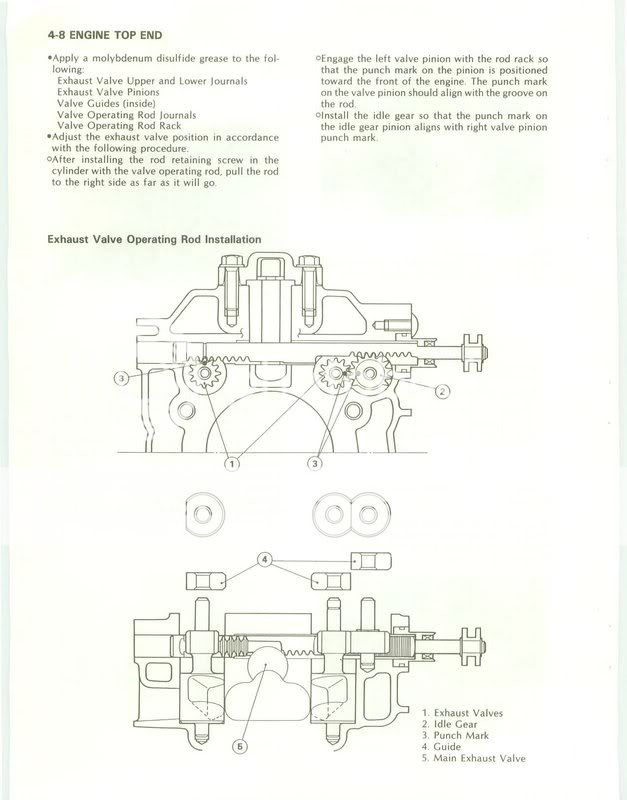

hi guys i,m doing the top end on my kdx200 and really enjoyed all the tips on the web site,but i,m just not getting the power valve timing the pictures and wording are good but i,m scared it my be wrong.when the main valve shaft is pulled out should theleft and right valves be open or closed.thanks a bunch george 0120x ruts d-37 ama

Hi julien can you tell me what book the pic came from as im after a good manual im doing the same thing at the moment and the on line one is not that good thanks Mike

this problem was solved by your help and a oem manuel
