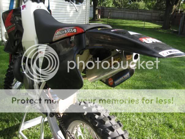

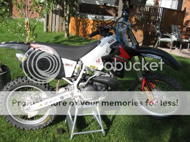

Here she is after buying her in pieces for 100 bucks. Put in Wiesco Crank, Piston, new bearings and seals. Came with a couple goodies
