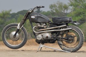

A Desert Sled example:
Triumph TR6C once owned by Motorcycle Hall of Famer Mike (Party Animal) Parti.
