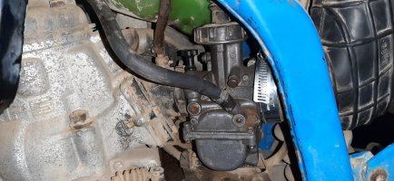

I pulled the carb out and cleaned it the flote was stuck so I checked the needle valve and it looked good and the pilot jet was clogged so I cleaned it. Reseated the needle valve and floaters they function as they should. The I put the carb back in place (the only things connected were the air intake, engine intake, the gas tube, and the thing that comes from the throttle) . After that I tried to start it and it won't.

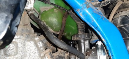

There is a couple of things that I have no idea what is there function:
1 there is a tube coming out of the connection between the carb and the engine connected to nothing.
2 and there is a green tank right under the gas tank which seems to have oil but I didn't mess with it.

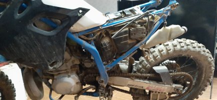

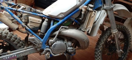

Here are some photos
Pull the tank (and flush it)... it looks like an oversized tank; the green you see is probably part of the tank.

It turns out after watching a random video on YouTube that I didn't assemble tha carburetor correctly I had the float setting untop of the needle valve not attached to it. Therefore the gas was not getting in.
I fixed that and changed the gasket whit RTV gasket maker and let it set till next day.
Then when I try to start it sounded promising then a very weird sound came from the engine kind like a gun shot not an engine sound I got scared and stopped for a bit. A few minutes later I tried again and it backfired, I said dang it I'll try until one of us die. Full throttle it started properly for a split second and stopped. Somehow I ran out of gas?? I had plenty in there where did it go? Anyway I poured more gas and it turned to be leaking from the carburetor overflow. I tryed to turn it on anyway it only runs in full throttle for a sec. So I knew that my pilot jet is properly clogged. I took the carb out and it was a mess in there the rtv was everywhere. And the float was stuck to rtv I cleaned everything and applied rtv again but in much smaller quantity and I'm waiting for it to dry.
