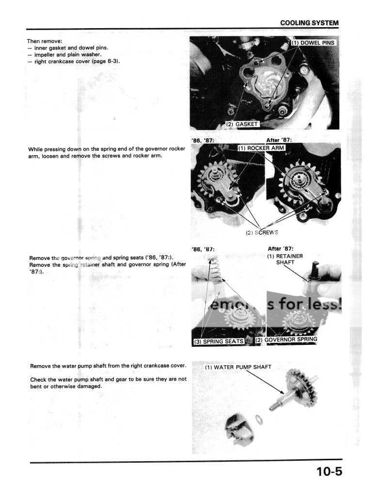

So im guessing its the seal on the water pump
what numbers should i get, And how do i take off the propellar from the shaft, i have the crankcase cover off, but i cant fidn a way to hold the end so i can turn it

Here are the instructions, the earlier page just says remove the water pump cover. You should probably reinstall the right side cover temporarily so you can use the engine to hold the water pump while you loosen the nut. I really doubt you need to remove the dowel pins for the pump cover. Don't put the water pump cover back on until after you install the engine right side cover. You need to be able to rotate the water pump impeller to line up the gear with the crankshaft gear as you install the cover.
