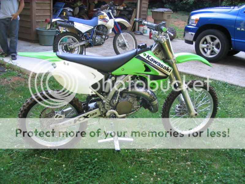

if you had it for 7 years and just changed oil then I believe you did indeed get your moneys worth out of her and if you are ready for a newer bike I could trade you for my 2003 kx 125 if you had a bit of your tax return to put with it... I always wanted an air cooled power valved and disk braked kdx.. it does have rear disk too right?

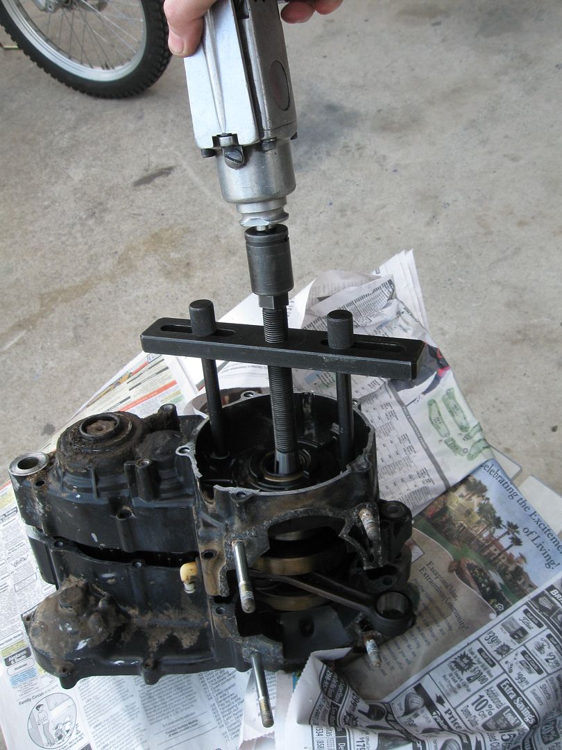

Ok. I do not have a case splitting tool. I will try to find one online. When I split the cases will the bearings stay in place in the case halves or will they stay on the crank shaft? Either way how will I remove the bearings without damaging either the case or the crank shaft?

If you beat new bearings in, beat on both races at once. Some engines can be tapped apart with a dead blows persuasion, some not. It was just apart should make it easier. The separator tool rules, and making one is not difficult. If the bearings stick to the crank, make sure to use a locking agent to help hold the bearing into the case. It can wallow out the bearing race, and the case will be junk.

Case splitting tool.
I use a twenty ton press and brass hammer to put the cases back together. I put a solid one piece fork seal driver that is longer than the crank spindle over the spindle so that it rests on a strong spot on the case around the main bearing. The other crank spindle has to able to drop through the plate that the other crank half is resting on, on the press bed. I line up the cases, the fork driver and start to press. As I press, I pause and tap the back end of the crankcase where the axle goes through with the brass hammer till all the trans shafts have seated into the places they need to be and the knock pins are almost into the cases as well. By that point, the case halves should press all the way together quite smoothly. :cool:

I would never advise doing that with an air tool, but. By hand, and keep it even.
I agree that if you forgot to remove every last fastener in the center cases and you had a very powerful air tool and didn't know what splitting the cases should feel and look like, a disaster could possibly occur. Admittedly, I have split dozens upon dozens of different engines over the years.

I don't think it's too small, 4 stroke 125's are much different than the 2 stroke 125's
see it it full sized with a 37 inch seat hieght :cool:
